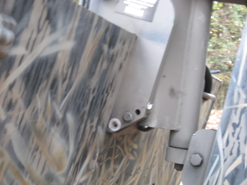

You should be seeing closer to 4000 rpms when running light.When you are running is the prop about half out of the water when its trimmed up?If not try moving the pin to the middle hole.

Change the pin to the middle hole.
http://i155.photobucket.com/albums/s295 ... G_1798.jpg

Pin already set to the middle. Came like that when i picked it up.

Hey Wagg, I was running between 3800 and 3870 in bottom hole when my motor was stock. Moved to middle hole and got all the way to 4000 trimmed all the way up. I now have mods, tried the lower and went back to the middle. Running about 4200 rpm trimmed down a little. Trimmed all the way up, I get close to 4400.
