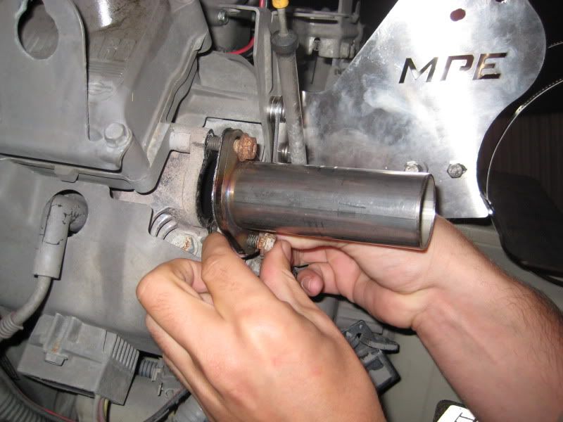

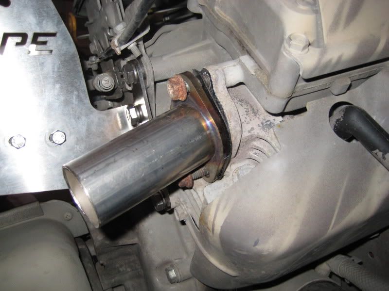

Start by removing the old exhaust. Remove the 4 bolts holding the exhaust to the manifold, 12MM socket.
Remove the brackets that are mounted to the engine. The whole stock exhaust assembly should come off easily once the bolts are removed.

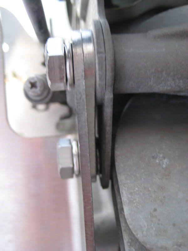

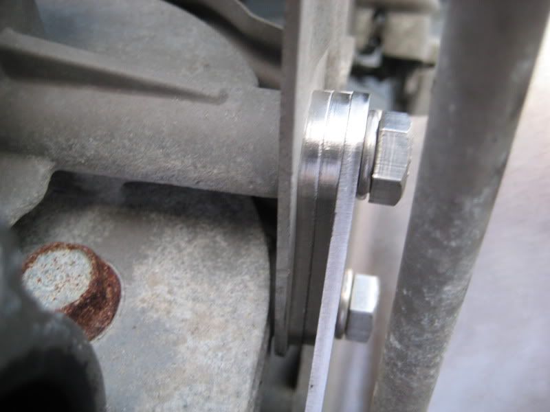

Remove the 4 bolts (two on each side of motor) that bolt into the governor. Hold a bracket up for a guide you'll figure out the two bolts on each side to remove. Here's a photo of the new bracket installed on the port side of the engine.

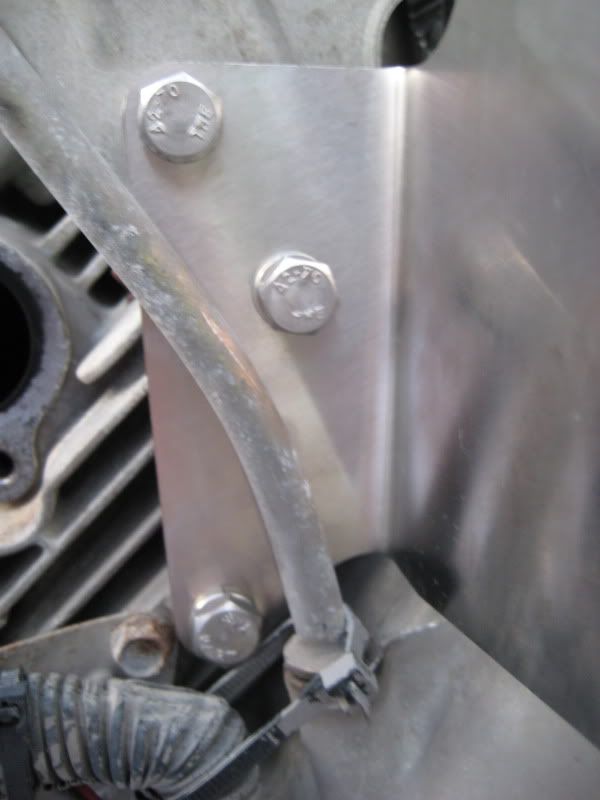

The trick to installing is to take the 2 long bolts (supplied with exhaust) and put them through the bracket. Put two spacers (also supplied) between the governor assembly and the bracket. Between the bracket and the head of the bolt remember to put a lock washer.
The above picture is of the two spacers installed, the bolts through there with lock washers and the small bolt with just a lock washer. The idea is that your compensating for the empty space so that the bracket will sit flush.

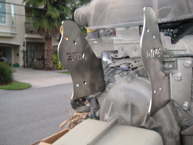

The starboard side bracket is a little tricky. First in the top hole grab a lock washer and bolt. Put lock washer on put bolt through bracket. Place a spacer on the back side of the bracket (top hole). On the hole just below that do the same thing however you'll use an extra lock washer to take up the empty space. See this photo.

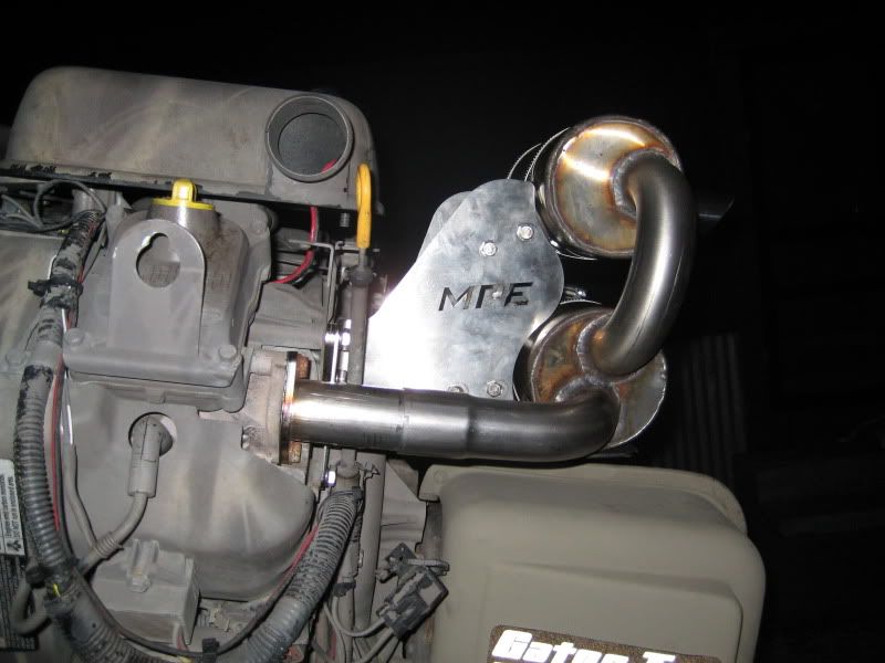

Here's a picture of the starboard bracket installed:
Both brackets installed:

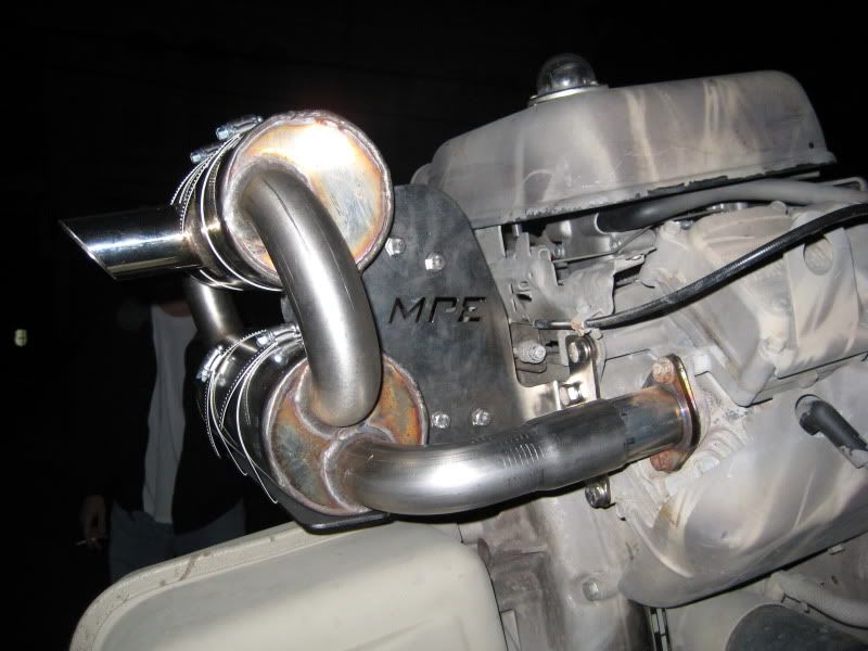

Install the flanges but leave them somewhat loose so you can get the muffler into them later don't forget to remove the old gaskets and install the new ones.

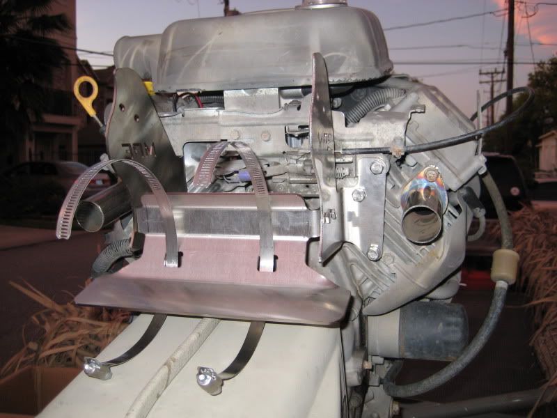

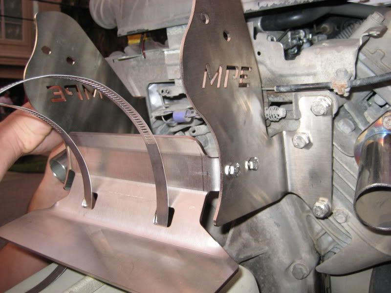

Go ahead and take the exhaust and place the supports included in the kit on the exhaust take two of the hose clamps around the top support and two on the heat shield support. Snug but not tight so you can adjust it later.
The Heat shield of course on the bottom and the smaller bracket on top. 4 Nuts and bolts in each will secure the supports to the brackets you installed earlier. The hose clamps go through the holes on the bottom of the heat shield and just around the bracket & barrel for the top.
I opted to install the top support to the exhaust first and then I put the heat shield onto the brackets before putting the muffler and whole package together.

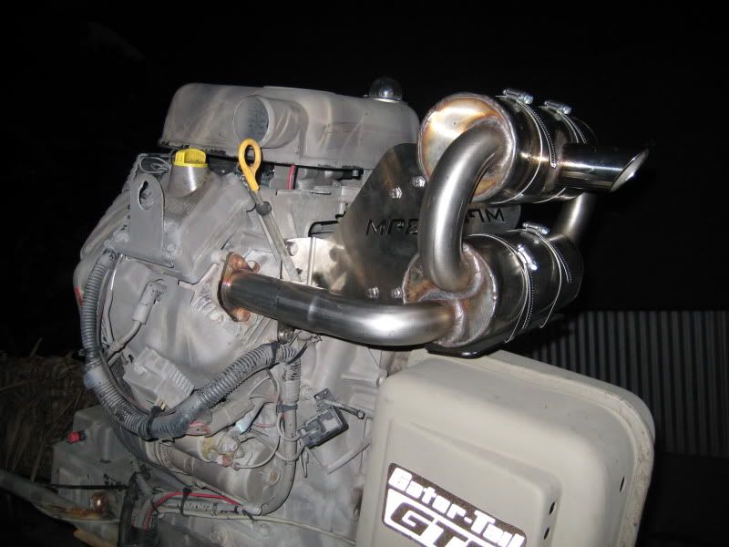

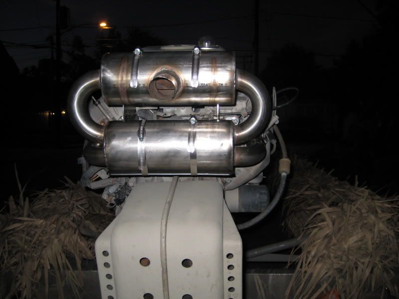

Looking at the photos below I notice I put the heat shield hose clamps on wrong... It was getting dark and I got into a hurry. Please note that the hose clamps on the heat shield bracket should come into the bracket from the back and wrap around the muffler and back to the top, not around the bottom of the heat shield as shown below
Leave everything loose so you can get the pipes to match up push in a hard as you can use a 2x4 and tap it in be careful not to "tap" to hard :roll:

spin your hose clamps so you dont have to look at the adusters. Put them behind the tubes it will look cleaner! Good job dude!

Yeah those shots were taken just for the install and review purposes I've since moved everything around.

Yeah, thanks again for the great post, pics, and instructions!

I really need to make some instructions. Thanks West End.
Robin1020, your throttle cable looks really close to the exhaust header. I have mine loosely pull tied to the lifting bracket bolted to the valve cover if you have enough slack. Hope you like it.

It has about an inch to two inches of space between the pipe and cable. I guess from the pics it does look like its touching. Would you suggest moving it out more?

Should be fine.

Need help, what is this part and where does it go?
No instuctions, but easy to install but this part stumps me.......Its a bracket for something. It does seem that I need i but want to make sure.

Dat is a cross brace. I think I have instructions and pics on how it is installed. I will try to find dem and pm dem to you tomorrow.

Could not find the directions. But the side with 2 holes goes on the right side (standing behind engine), sandwiched between the engine block and the exhaust bracket. The side with one hole is bolted to the left side exhaust bracket.

Thanks, got it!
Would ob f been better before I put it ALL together the first time......BUT it will go on alot quicker the 2nd!

Is that cross brace required for the GTR35 install? I don't think i saw it up top on WEA install instructions, but just want to double check.
I just purchased a second hand MM and am missing a couple spacers...left a voicemail with MM Exhaust this morning. Your instructions on the website show the use of 4 spacers, but i see up top that WEA only used 3...what do you recommend?

The cross brace was not available when I first purchased the MM Exhaust. I think the brace replaces the need for a spacer? I installed my MM-X in like 10 minutes. It's very easy put the thing together slap it up there if it looks like its not sitting flush throw a spacer in there take one out etc.
I'm sure Glider will jump on & explain it

Yes, cross brace is needed. I am calling you now.
